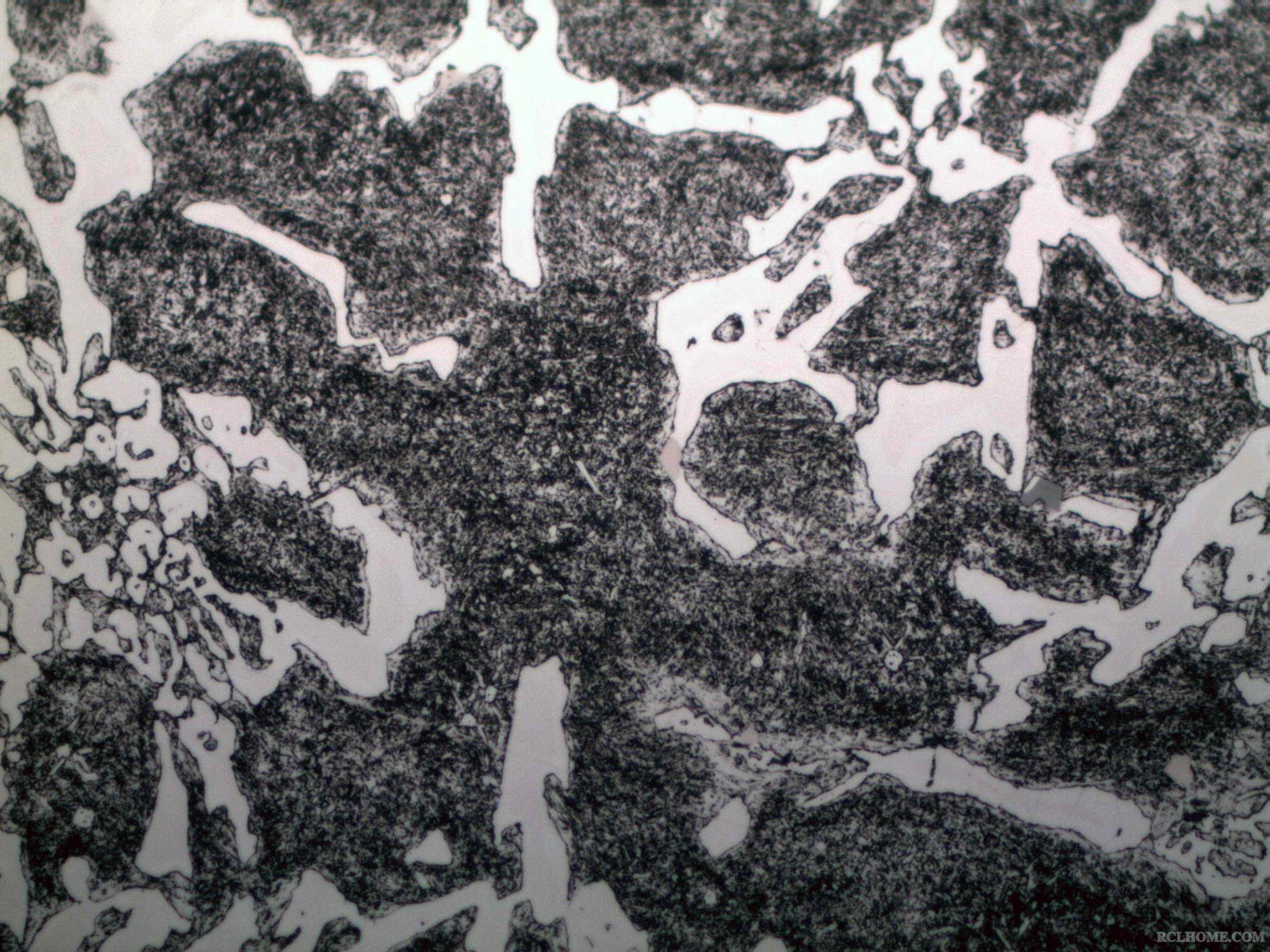

高铬铸铁件,高温空冷加500度回火后x1000组织,大神们帮忙看看
吉祥如意 + 10
发表于 2014-1-24 22:05:41 | 显示全部楼层
白色的应该是碳化物,基体是什么组织?高温空冷后是马氏体组织?500度回火后还是马氏体吗?请高手来回答一下
发表于 2014-1-25 11:59:24 | 显示全部楼层
现在硬度是多少?
发表于 2014-1-25 12:11:41 | 显示全部楼层
拍个低倍的呗。好像先析相都出来了,低倍可能会有网状渗碳体。

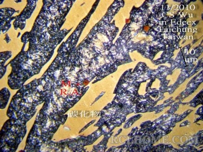

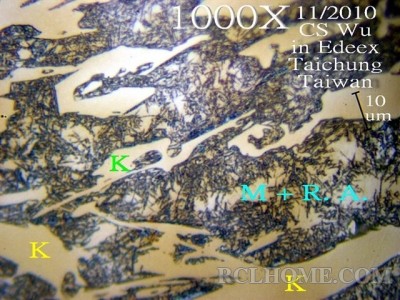

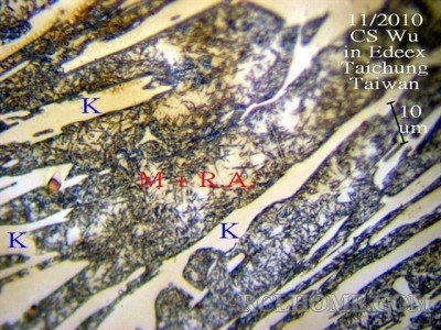

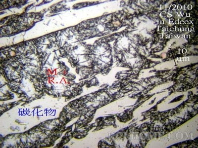

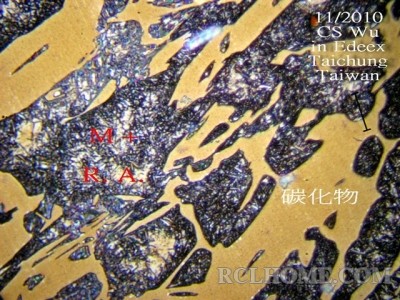

发几张吴老师的高铬铸铁照片。
A Cr25% alloy cast iron part for shot peening machine.
The part wore-out prematurely because of the excessive % of R.A.
in the matrix (white). M : black short needles.
There are a couple of  possibilities leading to this fault.
Since you are "the selected few", they are left to you to ponder.
I am not telling here.
