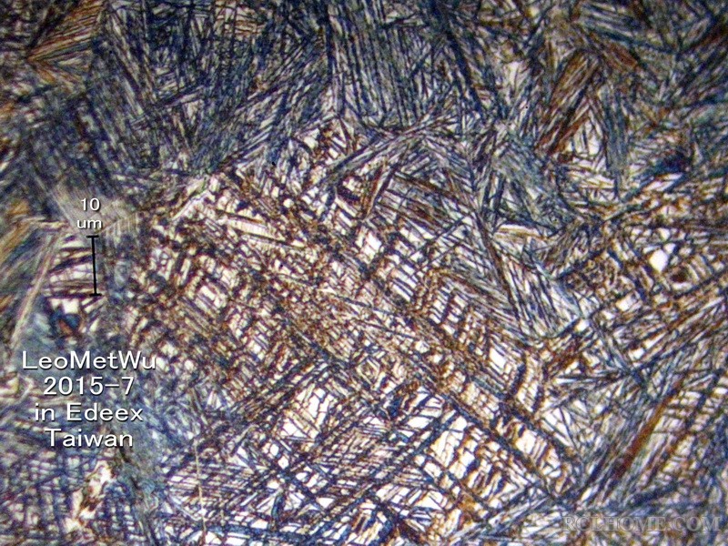

What is this beautiful microstructure?

我猜是奥贝球铁,贝氏体等温淬火得到的贝氏体组织

马氏体+残余奥氏体

下贝 残奥

Lower bainite and a small amount of martensite.

有点像高速钢淬火异常组织??

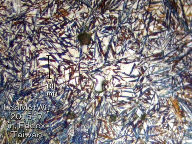

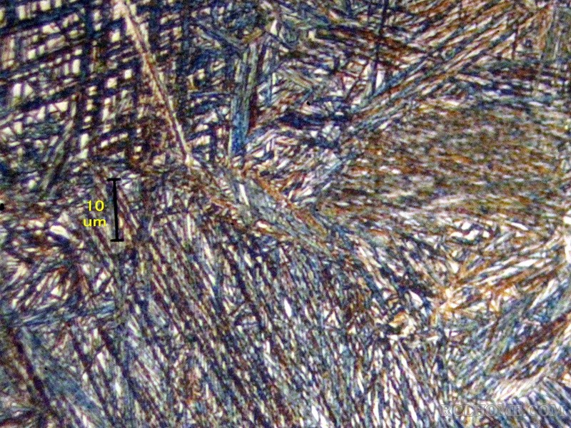

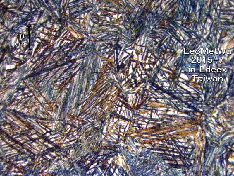

Enjoy these photos, if you guys may.
Carbide, shrinkage pores, Martensite and lots of Austenite are often seen in the LFZ.
----Artwork from the oldest metallurgist 金相工 in Taiwan
white network area of the photo below. These areas are last-freeze zones which are solute-rich. Carb ...

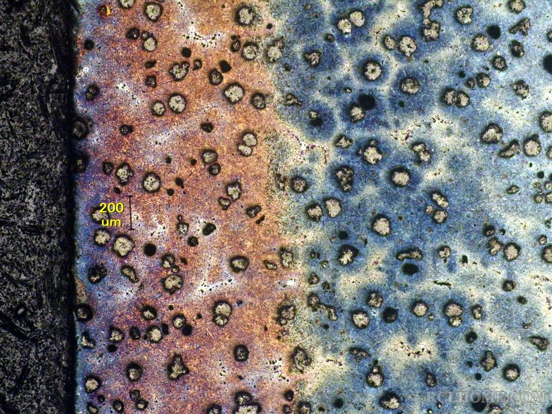

left: induction hardened; right: ADI

表面加热,等温淬火ADI?
