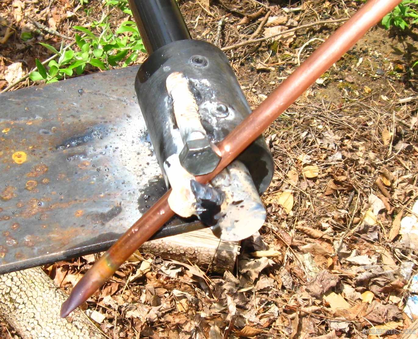

把3/8"铜管弯成紧密的螺旋线不是一件容易的事,它不光需要招数,还需要手艺,在此我来展现我的技艺。招数就是往管子里填干砂,填完后震实,封死端部,就可弯成任何直径。
往下看我的手艺
The jig consists of only 2 pieces.  An axle, called the mandrel, that sets the coil's inside diameter and the combination bearing and work rest/guide.  For the coil at hand, I used a 1" machine shaft and a 1" rigid coupling, both obtained from McMaster-Carr.  I don't happen to have a vice at the moment (can you imagine a nerd without a vice?) so I welded the coupling to a piece of plate and clamped it to the bed of my medium duty box van using C-clamps.
A small length of bolt comprises the work rest. Another piece is welded to the axle to form the retainer.  The part of the work rest that contacts the tubing is contoured to fit the diameter of the tubing using a Dremel tool.
This shows another view of the mandrel and work rest
Yet another view.
Here the tubing is positioned to start the bend.  It greatly helps to put a little moly-loaded grease on the tubing and the rest/guide.  Be sure to leave plenty of excess tubing at the start so that you will have the leverage necessary to bend the end to shape to fit the capacitor
The first turn is made.  This is the hardest.  The mandrel is being turned with a pipe wrench.  A handle was not welded on because the axle has to slide out of the bearing to remove it from the finished coil.  Someone with a mill-drill or milling machine could come up with a much better crank but for me the pipe wrench worked fine.
Several turns have been wound here.  You'll notice a couple of things. One, I cut the head off the bolt that formed the rest/guide.  Too much friction. The result of too much friction is the denting of the tubing under the mandrel piece.  A well lubricated bearing and well lubed tubing require little effort to bend.  An almost mirror finish on the part of the rest/guide that contacts the tubing helps a lot.

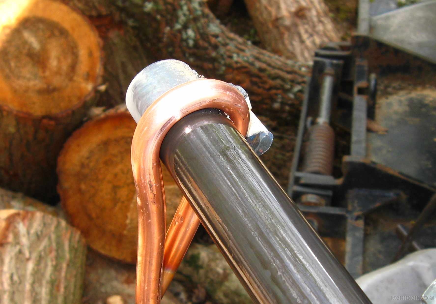

Winding is complete.
The capacitor is held up to the coil to assist with bending the coil leads.  Beneath the coil is visible an early version of a Litz coil that I wound from enamel coated motor winding wire.  It proved the efficacy of Litz wire and demonstrated that I ought to get some real manufactured wire.
The major advantages of the copper tubing coil is that it can be made with hardware store materials and it can be water or air cooled.  These benefits outweigh the added efficiency that the Litz wire provides.

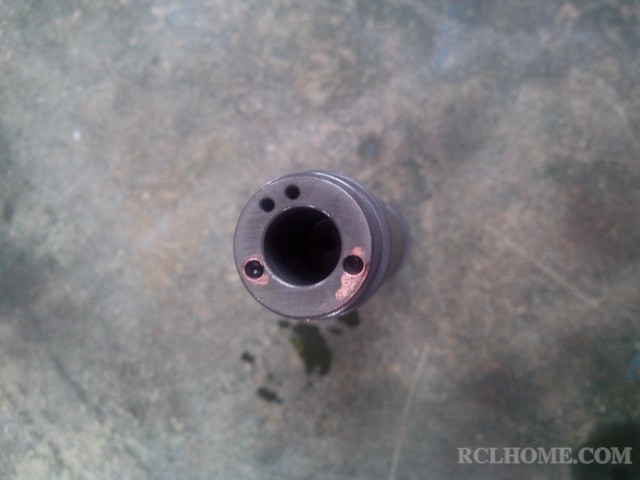

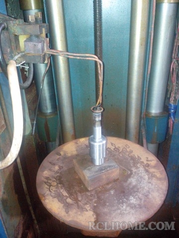

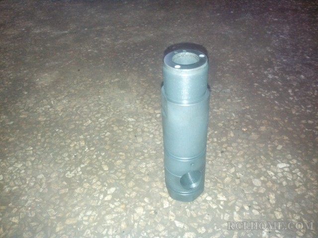

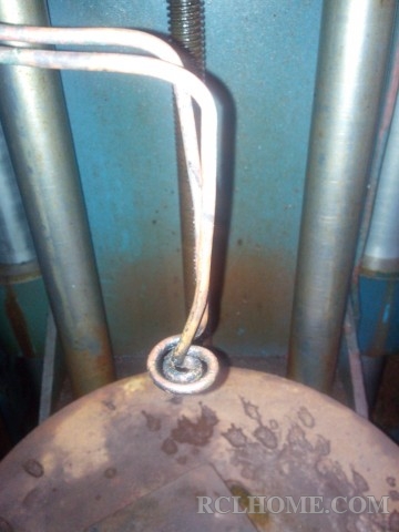

我就不再发帖了,就将就版主的帖子发表一下。这是我一个朋友的工件和感应器,他说让我了解一下,以后出问题方便讨论。现在的问题是那个孔要过热,但是工件小,全部去塞铜又麻烦。我建议堵上耐火棉或粘土(好像在那里看到过)。我看了一下他的感应器,我个人觉得是不是应该在有孔的地方把感应区翘起来一点?他以前做裂一批,现在他怕得很。还问我制作感应器的方法(这个我那里知道啊!) IMG_20130227_091025.jpg IMG_20130227_085254.jpg IMG_20130227_090155.jpg IMG_20130227_090221.jpg 前辈们给点建议,在不塞东西的情况下,怎么弄感应器才能防止孔过热开裂。谢谢了!

堵上耐火石棉或粘土可降低淬火应力,并不能有效解决加热不均匀引起的淬火裂纹问题。
铜条屏蔽的效果要好些。
末端提前终止加热或加大扫描速度、控制好末端的冷却,末端部分不要淬硬。
孔带丝扣的,孔底部也易裂,很麻烦。。。
龟山淬火 + 20 谢谢回复!

搬运工的方法是正解,那个孔是感应加热的地雷,就是孔内有水无水,淬出的效果区别很大,频率,功率都有影响
